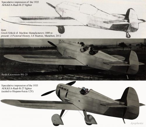

I've revised the above AEKKEA-Raab designition list slightly. The eBook Greek Vehicle & Machine Manufacturers 1800 to present: A Pictorial History by L.S. Skartsis has a section on AEKKEA-Raab but doesn't add to what is already available on Wikipedia. It does, however, have an artist's impression of the R-27 fighter (below, top).
This R-27 impression is acknowledged to be based on a well-known photograph of the Raab-Katzenstein RK-25 light aircraft (below, centre). Not to denigrate the efforts of whomever created this image but it really just depicts a single-seat RK-25 with a fighter-like cockpit canopy and tailwheel added.
So, I decided to have a go at a speculative impression of the R-27 myself. My speculative R-27 image began with the same RK-25 photo. I scaled a SPAD S.510 and added its HS.12Y engine. That dictated that the Raab's fuselage be deepened to match. The empennage was also enlarged - to cope with a seven-fold increase in horsepower.
I left the cockpit open. A canopy may well have been fitted to this 1935 design (and the canopy of the RK-25-32 would be a plausible reference for for its appearance) but I have no evidence for this. Still The speculative R-27's main undercarriage has been lengthened and I fitted spats (similar to those on the Schwalbe II, SX-AAL). However, I left the RK-25's tail skid (there being no evidence for a tailwheel on the R-27 that I am aware of).
Thank Wurger! Totally speculative, of course. But rather more plausible than that first effort, I hope ;)
