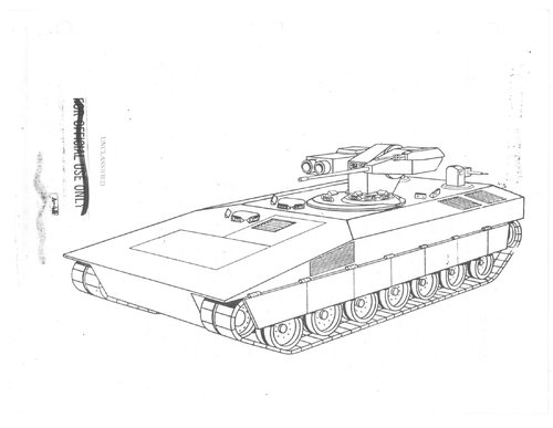

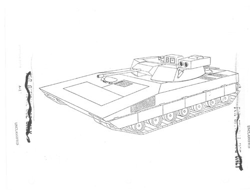

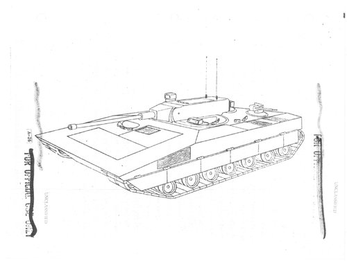

1978 - SAIFV proposal, Abrams-based HIFV with several armament options including ARES 75mm

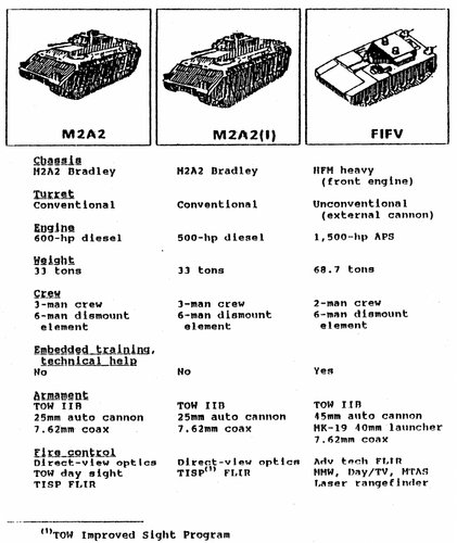

late 1980s - HIFV was considered in Heavy Forces Modernization/Armored Systems Modernization program - but it was not necessarily based on Abrams, and I do not remember if they were still looking at 75mm
IIRC the HIFV was looking at 45-60mm gun armament on a common chassis with the Block III MBT.
If you search ”ASM” I had posted some Congressional testimony on the Armored Systems Modernization program which was a smaller program than HFV.
Probably the 45mm ARES design which also used cased-telescoping ammunition.
