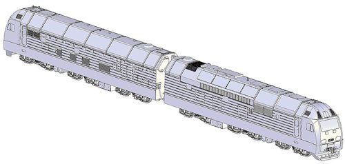

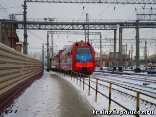

a new Russian gas-turbine locomotive using the same engine as the Tupolev Tu-160
Stargazer2006
25 June 2009
13,214
1,531

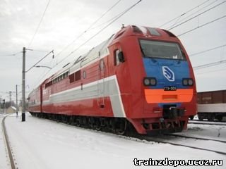

The GT1 is a new Russian dual-section freight locomotive of 2 (Bo-Bo-Bo) axle arrangement, with a total weight of 300 tonnes and a service speed of 100 km.h. The prime mover is a two-shaft gas turbine developed by SNTK Kuznetsov from the NK-321 turbofan that powers the Tupolev Tu-160 Blackjack strategic bomber. Rail power is 8,3MW. Tankage is provided for 17 tonnes of fuel, enough for a 750km trip, but the engine can also run on LNG. Tranmission is AC/asynchronous. Up to 3 GT1s can work as multiple units. The locomotive is developed on behalf of the Russian railway system RZD by Voronezh Locomotive Plant under supervision of the All-Russian Research and Design Institute of Technology (VNIKTI) in Kolomna. RZD have a plan to purchase up to 100 GT1s for heavy freight train haulage on non-electrified lines, in replacement of older diesel locomotives, if the evaluation currently underway with the GT1-001 prototype since 2007 (and during which it has pulled consists up to 15 000 tonnes and 159 wagons) proves successful.

How fast was it going with the 15,000 tons?
I don't know. Trials started with 3000 tonnes, then 11 000 tonnes (120 cars) etc., before the one I mentionned. Please note those are SI tonnes, as legal in Russia, not tons.

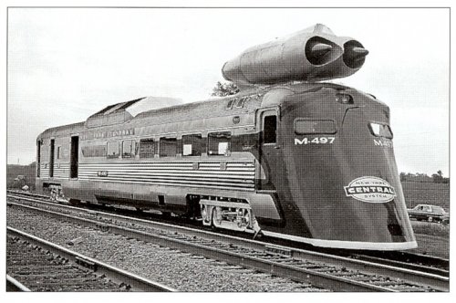

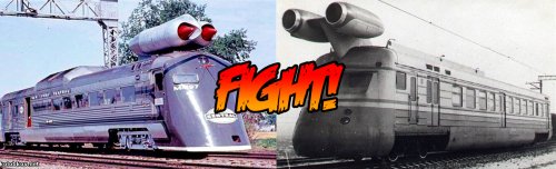

Was there ever an idea dumb enough that one side said to the other "you can have that one"? (Russian jet train on the right.)
Technically, neither was a locomotive; both were railcars. NYC's M-497 "Black Beetle" was a Budd RDC-3 railcar (with GM bus engines and transmissions ; they were kept and ran to power the auxiliaries). It had a long career as a railcar, before being fitted with those two GE J-47-19 engines, and after they were removed (delivered 1953, stricken 1977). The Soviet experiment used the control unit of an ER-22 elektrishka EMU, fitted with two Ivchenko AI-25 engines borrowed from a Yak-40.

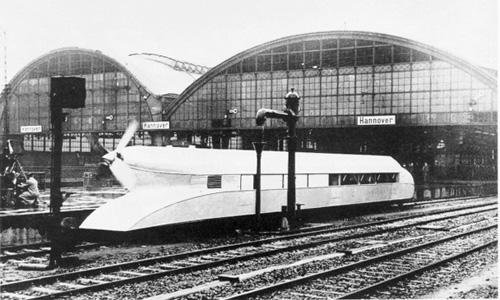

NYC had initially planned to use a Rolls-Royce Dart turboprop borrowed from a Vickers Viscount (which would have been a logical evolutionnary step from Flugbahn-Gesellschaft mbH Schienenzeppelin, which had a propeller driven by a piston engine).

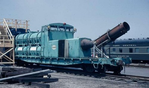

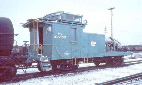

Anyway, those two GE J-47 engines found a new role after the M-497 experiment and ended has rail jet snow-blowers/melters.
