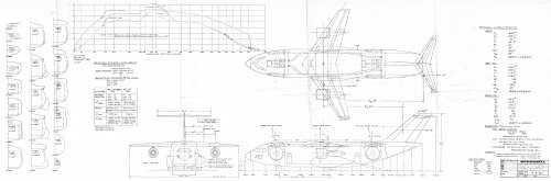

Hi All -
A retired McDonnell Douglas engineer passed along a package of drawings to the Museum yesterday and the attached drawing was one of them. Tiny wings!
Enjoy the Day! Mark
Mark Nankivil said:
Tiny wings!
The idea is that with a VTOL system, you only need enough wing for efficient horizontal cruise, which means much less wing than is needed for runway takeoff. This greatly lowers weight and drag. Of course if something goes wrong the glideslope is a little harsh.

Off topic, but you have answered a question I was posing to myself. Why did the P1154 have such small wings?
Thank you.
It's a universal tradeoff. Even with CTOL aircraft, sometimes the designers put tiny little wings on the plane (see: F-104). It makes takeoff and landing sporty, but it makes high speed flight much easier and more fuel efficient.
I could see a military transport like this one, with tiny little wings optimized for cruise, but I can't readily imagine the FAA being too happy about a civilian jetliner with no ability to safely glide to a landing.
I thought no airliner since the 747 was able to "safely glide to a landing" anyway, being all aerodynamically unstable and kept in the air only because of constant computer-controlled change of incidence of the flaps, ailerons, etc. Isn't that so?

McDonnell's submission to the CX-6 competition?
The programm was canceled in 1967, so it would fit in the timeframe.
Hi XB-70,
I think you are right,and McDonnell submitted a proposal for this contest;
http://www.secretprojects.co.uk/forum/index.php/topic,1008.15.html
