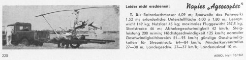

For the friends of small helicopters - the Napier "Agrocopter" (from "aero" magazine 10/1961). Never heard of a helicopter company with this name - any connection/relation to the Napier engine manufacturer? I don't believe.

Napier the engine company did produce aircraft designs from time to time. In 1959 they tendered the "Seahorse" anti-submarine missile, see https://www.secretprojects.co.uk/forum/index.php/topic,25507.msg259183.html#msg259183
The Agrocopter looks like an autogyro to me, after the classic Bensen/Wallis pattern. It could well have been by the usual Napier engine Co. but I can find no other reference to prove it either way.
They got the name slightly wrong ... G-21-3 was a prototype Napier Agricopter, derived from the Bensen B.SM (B.SMEJ) Gyrocopter. Also known as the Napier-Pan Britannica Agricultural Gyroplane and the Napier-Benson Gyrocopter.
Three Agricopters were built in 1961 (likely all at Luton): G-29-2, G-29-3, and G-29-4.
http://www.nwamuseum.co.uk/AIRCRAFT%20MANUFACTURE-1.pdf
Aircraft Manufacture in West Essex, North Weald Airfield Museum , 2010, pp.11-12
