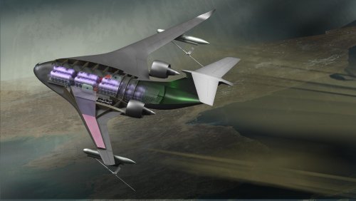

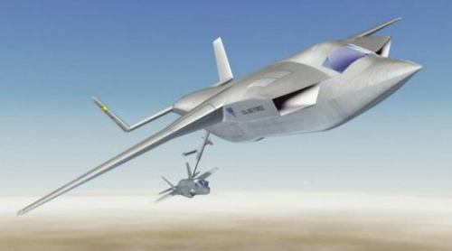

This is not a LO platform. There's another though.

Looks cool but too expensive.  Sometimes I wonder if there's somebody who's sole function is to come up with ways that guarantee program cancellation.

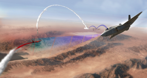

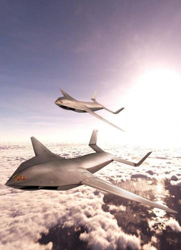

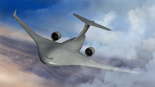

Stealthy Mobility and Support Aircraft

What would happen to the Flying Boom once it had refueled a fighter or bomber?  Looks rather cool if I say so myself.   B)

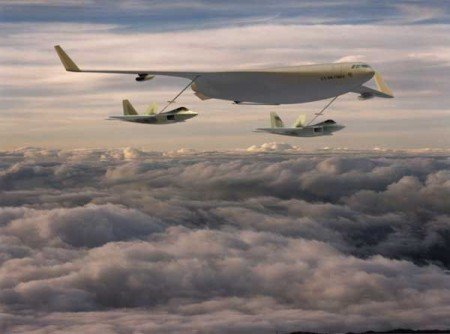

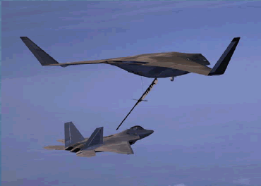

A couple more images of stealth tanker concepts:
Nice find my dear Dynoman.
Of the two designs above the one that I think that has the most going for it would be the Blended Winged Body tanker.  Also would it really be able to refuel two F-22As at the same time?
Seems like the two most limiting issues in fueling fighters is refueling rate, rate the receiver can take on fuel, and time waiting for your turn at the pump.  For fighters needing fuel every hour or so it's a logistical bottle-neck that takes them away from their cap mission.
Having two booms would be a game changer for refueling fighters.
The concern w/two booms is not refueling fighters but having three large aircraft in such close proximity.  If the solution is limited to fighters as receivers then it's much less of a problem.
Current tanker solutions are a combination of cargo and tanker requirements.  So the tanker has to be large enough to participate in the AMC requirement.  There just aren't enough C-17's and C-5's to meet the 1-4-2-1 needs.
At some point USAF will want a stealthy tanker w/C-17 capabilities and size.  With current stealth tech this is going to be extremely expensive.  This is why the KB-21 variant interests me as an interim solution.
I'd be interested in a dual boom KB-21 based solution as perhaps a Block-20/30 target after autonomous boom refueling is perfected.  That aircraft would not need a boom operator and by then the lessons of initial, low risk Block 10 aircraft would be integrated into the tanker fleet.  That aircraft might have larger wings to accommodate the retracting dual boom design with perhaps wet tanks along the center of the airframe.  The unmanned capabilities of B-21 would also be further along should it make sense for KB-21.

The obvious solution is right here.  Tanker, transport, and cruise missile carrier, all in one.  And cheaper than a "stealth" tanker.

I like the LM design - C-5 cargo capacity with 1/2 the C-17 fuel consumption.  It's a 'technology leap' and the history of technology leaps is long development times, unexpected costs and under performance.  Like to see more risk reduction to better ensure the tech maturity is there before a program is begun.
Ran some numbers and a C-17 would be >~US$300Million including EMD costs in 2016 dollars.  Can't expect the LM design to be any less expensive in acquisition. Sounds like operational costs would be dramatically reduced though.
Don't see it going into a high contested area to bring back a receiver though.  Still see a need for a stealthy tanker (with a boom) in the 2025-2035 - if - the A2/AD projections are correct.
I'd think this design would be less risky, and far more useful, than a full BWB or stealth solution.  Also, the only way "technology leaps" are accomplished are by doing them.  They don't come for free.
"Like to see more risk reduction to better ensure the tech maturity is there before a program is begun."
Like what?  They're already (supposedly) planning on flying a subscale X-plane.  Aside from that what else is there to be proven?  All the construction methods are already being used.  All the required avionics could be based on existing hardware.  Aside from the shape, there is no required new "tech" for this design.
Autonomous refueling
Simultaneous multiple boom operations w/large aircraft
Whatever is required to ensure loads and constructed weight of a blended wing this size
Engine tech maturity - 700k lbs w/2 engines ?
STOL performance expectations
What will it's Load Classification Number (LCN) be?  # of runways available to it
I'm concerned about a 'kitchen sink' approach that takes forever to accomplish.  Would rather see meeting the perceived needs w/multiple aircraft.
There is a need for an aircraft w/a C-5 load & LCN.  Don't know if it needs the austere airfield capability as well as a tanker role.
Where are you getting those thrust requirements? The re-engined C-5s have ~ 200k lbs
or roughly the same output you get from 2 x GE9X which the LM guys modeled (roughly via the Genx)
for the HWB.
That's not airframe specific.  There's no reason they couldn't build a new tanker without it and implement it at a later date.  For that matter, there's no reason they couldn't do that with older tankers.
Given that no existing tanker has multiple booms, how would you test this without building an aircraft with multiple booms?  And why would you want or need to?
You mean like the 777-300ER that's been flying for well over a decade?
Why would it be any different than any other heavy aircraft?  The runway doesn't care what's above the wheels.  Furthermore, there's nothing that says you have to have a 700,000lb aircraft, or if you do, that it needs to weigh that going into every airfield.
Don't see how that's the case here at all.  Pretty much every tanker in the US (aside from the Super Hornet) is a tanker/cargo aircraft, hence the "KC".
So build the C-5 replacement as a HWB and make the KC-Z a smaller HWB.

- two aircraft flying in formation more than double the individual RCS
theoretically the total rcs from a collection of scatterers is the square of the phasor summation of the square-roots of the rcs of each scatterer...
so for two objects the maximum (ie. coherent sum) of the echo cross section would be (given: a=rcs of 1st object, b=rcs of 2nd object):
(a^1/2 + b^1/2)^2
if both objects had the same rcs value (ie. a=b) then the maximum coherent sum would be 4 times the rcs of the individual object...
if one object had a fractional rcs as compared to the other object's rcs, ie. b=k*a, where 0<k<1, then the coherent maximum would be:
a * (1 + k^1/2)^2
so if for example your "stealth" tanker had an rcs of 1 sqm and your fighter had an rcs of 0.001 sqm, the maximum coherent rcs of the two combined would be: ~1.06 sqm, or just a bit over 6% higher than that of the tanker alone...
if you got your tanker down to an rcs of 0.1 sqm together with the same 0.001 sqm fighter, then the coherent rcs of the two combined would be 0.121 sqm, or around 21% higher than your tanker alone...
one can also add in the rcs of the boom as a 3rd object in the system and work the math to figure out what ratios of rcs for each object in the system would be needed to get an acceptable rcs increase for the combined system over that of the tanker alone...
R3, thank you for running these numbers.  Any thoughts to what would happen if you added a third aircraft?
Scenario is a four aircraft strike package converging on a tanker w/two fighters refueling on two booms simultaneously.
for the HWB.
Sorry - wasn't clear.  I was talking about the max weight of the aircraft.
I presume it starts w/where can these beasts operate.  US seems to experience a number of general limitations on moving material in wartime.
eg.
  Political limits - Countries refuse access.
  Runway strength - LCN
  Runway length for landing
  Runway length for take off
  Ramp area for the qty of aircraft
  Some airfields may be unavailable due to working Maximum On the Ground (MOG) or airfield damage
  Air mobility enterprise is dependent on commercial partners to meet surge wartime requirements
Austere airfields typically include the following
  Runways <4000ft and as narrow as 60 ft
  Payloads contained by runway length and weight bearing capacity
  Ramp space <100k sq ft w/single narrow taxiway and not turnaround areas at end of runway
  Ground support & equipment usually nonexistent
Ideally, new airframe designs will open up more airfields for operational use - not the same or less.  C-5 certainly doesn't use austere airfields.  My concern is that I wouldn't expect a 700-800k lb aircraft to have a critical field length for takeoff of ~8000ft (NATO spec) with qty 2 75k lb Genx engines.  If that's the design, I'd be concerned that weight gain during EMD would put right back where the C-5M is today.
So two concerns w/engine development.
1)  If the design is for use on austere airfields and C5 can't do it today then I don't see how 75k lb thrust GEnx accomplishes task.
2)  If design is for new C-5, concern is that 'weight gain' during EMD will get us right back to C-5 specs w/5000-6000 ft minimum runways.

@NeilChapman:
if you work the general equation for the case of 1 tanker and N fighters you get (again this is assuming no mutual interaction between scatterers, so no corner reflectors formed between objects, etc):
given:
a = rcs of tanker
b = rcs of fighter = some fraction of tanker rcs = k*a, where 0<k<1
n = no. of fighters
total echo cross section = a * (1 + n*k^1/2)^2
so for two fighters = a * (1 + 2*k^1/2)^2
using the rcs values in the previous example, "stealth" tanker rcs of 1 sqm, fighter rcs of 0.001 sqm, then total echo area is ~1.13 sqm, around ~13% higher than the tanker alone...
if tanker rcs is smaller at 0.1 sqm, fighter rcs is still 0.001 sqm, then total echo area is 0.144 sqm, 44% higher than the tanker alone...
if you explicitly include boom rcs in the system:
c = boom rcs = some fraction of tanker rcs = p*a, where 0<p<1
then the equation for 1 tanker, 2 fighters, with 2 booms would be:
a * (1 + 2*k^1/2 + 2*p^1/2)^2
if you used for example, tanker rcs of 1 sqm, fighter rcs of 0.001 sqm, and boom rcs of 0.002 sqm (boom isn't as "stealthy" as your fighter), then the total echo area would be ~1.33 sqm, 33% higher than the tanker alone...
for a smaller tanker rcs of 0.1 sqm and with the same fighter and boom rcs used previously, total area is now ~0.22 sqm, a full ~2.2x larger than that of the tanker alone...
1.  That's not airframe specific.  There's no reason they couldn't build a new tanker without it and implement it at a later date.  For that matter, there's no reason they couldn't do that with older tankers.
2.  Given that no existing tanker has multiple booms, how would you test this without building an aircraft with multiple booms?  And why would you want or need to?
3.  ?????
4.  You mean like the 777-300ER that's been flying for well over a decade?
5.  ???
6.  Why would it be any different than any other heavy aircraft?  The runway doesn't care what's above the wheels.  Furthermore, there's nothing that says you have to have a 700,000lb aircraft, or if you do, that it needs to weigh that going into every airfield.
7.  Don't see how that's the case here at all.  Pretty much every tanker in the US (aside from the Super Hornet) is a tanker/cargo aircraft, hence the "KC".
8.  So build the C-5 replacement as a HWB and make the KC-Z a smaller HWB.
1.  Wasn't suggesting it's aircraft specific.  It's an advantage that reduces complexity/crew in the mission and if you want it it should work prior to having airframes waiting for the tech.  Sort of like the AAG problems on the Ford-Class.
2.  a.  I'm not an AE but I expect it can be modeled then tested.  b.  Lot's of airspace and ramp space around a tanker.  Also reduces wait times for fighters on cap missions or striking time sensitive targets of opportunity.  Strike mission of 4 F-35's refueling time cut in half + requires two tankers today increasing airspace and ramp space.
3.  Can they build a blended wing this size that meets the load requirements within the weight target or will it end up heavier which cuts into aircraft capability?
4.  777 has a 10k foot takeoff requirement.  NATO spec is for 8k foot runways.  Austere is 4k ft.
5.  LM provided fuel savings and load info.  Provide specs comparing it to C-5 or C-17 for other design expectations like runway requirements, single engine takeoff limits at specific temp requirements, fuel load at max load, etc etc.
6.  I agree.  C-5 was designed to fly into unimproved airfields.  AF doesn't use it for that because the MCR has been so crappy, it's not capable of reversing unless it's basically empty and engine blast creates a FOD hazard.  If the LM proposal is basically for outsized material only and will fly into basically the same 5 pacific en route airfields and still won't do airdrop missions then set that exception up front.
7.  LM proposal looks like a C-5 replacement w/tanker thrown in - hence kitchen sink comment.  There are divergent requirements for inter-theater lift vs intra-theater lift vs tanker cargo augmentation.  It will be incumbent upon the USAF to set requirements and not change them - and not want a 100% solution.
8.  Whatever fits the mission.  Just want the technology maturity (for whatever particular purpose) to be there prior to getting started on the new airframe.

« Reply #53 on: September 24, 2016, 09:50:26 pm »
@NeilChapman:
Thanks for doing that!
Isn't that still pretty low compared to the RCS of a KC-46 which is probably, what, 100?
This rcs would allow the stealth tanker to operate much closer to the battlespace than the KC-46 - no?  Perhaps with the advantage that should a threat approach the stealth tanker can button up and disappear - or - use whatever remote weapons systems control the b-21 will have (same as F-35?) to engage the threat.
Well, it's a lot of conjecture.  Too many 'ifs'.
There's no reason to hold up hardware development while waiting on software, when one isn't dependent on the other.  A new tanker can function just fine without autonomy, or reduced manning.  You're holding up production of the 2017 Corvette while waiting for the perfect sound system to come along.  It's not justifiable.
The point remains: how are you going to test an aircraft with two booms without building an aircraft with two booms?  Any aircraft you tried to scab two booms on wouldn't be a BWB and therefore the results would be of limited use.
How will you know without doing?  How do you know what you propose isn't already being worked?
And?  Your comment was about the viability of a 700k twin.  You just tacked on shorter runways after the fact, but that really changes nothing.  It's a function of lift, drag, and power, all of which can be dealt with.
See above.
7.LM proposal looks like a C-5 replacement w/tanker thrown in - hence kitchen sink comment.  There are divergent requirements for inter-theater lift vs intra-theater lift vs tanker cargo augmentation.  It will be incumbent upon the USAF to set requirements and not change them - and not want a 100% solution.
Are the KC-135, 10, 130, and 46 "kitchen sink replacements"?  Why would this be any different?

Didn't mean for it to be a cheap shot.  Just pointing out that co-development has had it's drawbacks.  DoD seems to have been getting away from this process since F-35 and Ford-class.
Again, apples and oranges.  A bit like saying we should have not produced the F-16 until the AIM-120 was ready because "co-development is bad".  One has very little to do with the other.
What exactly would need to be co-developed for the HWB?  I would think the greatest risk (after control laws) would be
achieving good STOL performance without the C-17's externally blown flap; the LM guys have some ideas from CCW to various forms of TVC.
Or just a huge lifting surface.
It wasn't clear to me how much lift the forebody generates at high AoA.
It's not inconceivable that conventional high lift devices would enable it to meet the STOL requirements
but the LM paper spends some time on dedicated powered lift systems.

« Reply #77 on: September 28, 2016, 06:01:33 am »
Not only must it be stealthy but it also has to fire lasers as well.
http://m.aviationweek.com/defense/us-air-force-wants-stealthy-laser-shooting-next-gen-tanker
For the life of me I can't understand why that would make sense in their opinion.
As I wrote 2 pages ago, just having dedicated Laser Interceptors flying in protection of the Tankers could solve the issue, with a sort of aerial Aegis system, without the need to make overly complex "stealth-airborne laser-tankers".
Stealth is not magic, you can't just say "we need a stealth tanker, and while at it make it capable of this, this and that".
Tankers, cargos and AWACS, at large, are not survivable assets, and will probably never be. They need to operate in safe areas as long as air superiority and the removal of A2/AD are not established.
If the enemy defenses range increases, the focus should be on changing tactics or adapting technologies in a reasonable way to get around a problem, not on creating a panacea/miracle aircraft to operate as in previous air-campaigns (and for the time being, "waiting" till that happens).
Moreover, there is no way a stealth-tanker could be reasonable from a cost-effective point of view, with 2 of its main capabilities (stealthiness and laser defences) that will be of use only in conflict.
And, once more, if radar developments catch up before a stealth-tanker reaches IOC we're back to square one, with a large aircraft which, at that far point in the future, may even have laser defences on board, but which stealthiness would be pretty much useless (unless, in the meanwhile, that too doesn't make exponential advancements, like being cheaper for example).
The people making the choices should ask themselves: "Is the problem now, in 10 years or in 60 years?".
Throwing ideas around is fine for creating a fertile environment, able to come up with solutions, but certainly not for much else.

Re: Air Force Could Pursue Stealthy Aerial-Refueling Tanker
« Reply #80 on: September 28, 2016, 03:56:11 pm »
The progress they are making in active aircraft defensive systems may change that assessment.
Large aircraft could carry a relatively deep magazine of towed decoys, kinetic intercept countermeasures, defensive DEWS etc. without much penalty.
« Reply #83 on: October 17, 2016, 04:10:49 pm »
Almost looks small enough to fold its wings and stick it on a carrier.
"DARPA Hard"  It ain't what it use to be.
Offline Rhinocrates
  • CLEARANCE: Secret
  • Posts: 164
« Reply #84 on: October 17, 2016, 07:06:50 pm »
Guessing that the bumps top and bottom are laser turrets.
« Reply #86 on: October 18, 2016, 10:55:18 am »
Not to nit-pick, but that doesn't look like a HWB. To me it looks more like a tube and wing with generous blending, i.e., it looks like there's a pretty distinctive transition between the fuselage and the wing, unlike the pictures above.
« Last Edit: October 18, 2016, 10:56:58 am by AeroFranz »
All modern aircraft have four dimensions: span, length, height and politics.   TSR.2 got the first three right - Sir Sydney Camm
Offline TomS
  • Senior Member
  • CLEARANCE: Top Secret
  • Posts: 2935
« Reply #87 on: October 18, 2016, 11:26:23 am »
Wonder if that changes with the proportions corrected.  That image looks pretty distorted.
Offline Rhinocrates
  • CLEARANCE: Secret
  • Posts: 164
« Reply #88 on: October 18, 2016, 03:44:51 pm »
Vertical axis compressed taking the half moon as a guide, contrast altered.
If I had all the money I've spent on drink, I'd spend it on drink.
Offline Mat Parry
  • CLEARANCE: Secret
  • Posts: 404
« Reply #89 on: October 19, 2016, 01:53:42 am »
To my eye this configuration looks more like a enlarged (manned) General Atomics Predator C avenger, not a HWB.
Offline George Allegrezza
  • Senior Member
  • Posts: 786
« Reply #90 on: October 19, 2016, 03:08:04 am »
Agreed. One could also make a case for a variation of the TR-X shape as well.
« Reply #94 on: October 20, 2016, 05:08:01 am »
Good Projects,thank you my dear Flateric,
but for this aircraft,it is just dream,never to be built,we heard about many tailless
transport and tanker airplane Projects from 1940s,1950s & 1960s,but nothing at
all we got.

« Reply #98 on: January 11, 2017, 09:18:15 am »
Lockheed Martin KC-Y/Z concept on display at AIAA Sci-Tech Conference.  Some Speed Agile similarity, especially the tail section.
https://twitter.com/TheWoracle/status/819210345659174912
https://twitter.com/TheWoracle/status/819211171442081792
(Moved from USAF future transports topic.)
« Reply #100 on: January 11, 2017, 04:57:13 pm »
Wonder where the boom would go and how the engine exhausts being where they are would effect stability when trying to refuel.
Offline NeilChapman
  • Posts: 866
  • Interested 3rd party
« Reply #101 on: January 11, 2017, 05:26:15 pm »
I'm not an AE so I'm really just asking.  With that wing design and expected load what kind of take-off roll would be expected?  Less than a KC-46?
It'd be nice to get tankers in to more potential airfields, not less.
At a guess...

« Reply #105 on: January 12, 2017, 02:33:34 am »
If the airforce decides to skip KC-Y and go to Z this LM's entry for the competition.
Lockheed Martin unveils wing-body tanker concept for refuel stealth aircraft
http://defence-blog.com/news/lockheed-martin-unveils-wing-body-tanker-concept-for-refuel-stealth-aircraft.html
Offline DrRansom
  • Posts: 512
  • I really should change my personal text
« Reply #106 on: January 12, 2017, 09:29:34 am »
What is interesting I'd that this is the most recent, or maybe first?, stealthy jet transport.
And it looks really weird. Fuselage lift, relatively highly swept wings. Just looks strange. The Speed Agile aircraft looked much more normal than this.
Offline red admiral
  • Senior Member
  • Posts: 546
« Reply #107 on: January 12, 2017, 11:51:33 am »
Probably not that low RF signature beyond something like Avro Vulcan. Not much in the way of planform alignment, hardly any cant on the tails. The only thing a bit "stealthy" is the engine installation, which still has clear los from frontal aspects unless some sort of radar blocker is used - with consequences for aircraft performance.

The blended wing/body designs will no doubt look odd until we get used to them.  When the F-117 was first announced I thought it looked odd but now the blended wing/body looks like a development of that.  I tewnd to agree that tanker assets would be best used where they can be defended in depth rather than risked within range of target defences.
What do you think about drone tankers?  It would cut down on weight and make it easier to carry self defence weaponry.  Yes, I know I have no ecperience of the Air Force or its tactics it just makes sense to me.
I'd imagine here:
Edit:
The more I look at it, the more I'm inclined to think it depicts a probe & drogue system rather than a boom & receptacle one. Unless those pods are supposed to house magical-telescopic booms...

If you will forgive me, just a thought. This Lockheed model would appear to have inherited some of the features of its forebears (to my eye this looks like a sleeker sexier evolution of some of the speed agile concepts). I can also see some F-117 in it too. But I wonder if there are some features that might have been passed on from the loosing Lockheed LRS-B design?
It's been clearly explained elsewhere on this forum that a flying wing is the only sensible platform for LRS-B (so nothing like this stealth tanker model). However if, in years to come, artwork on the Lockheed design is released my guess is that there could be a family resemblance in say the intake designs.
Marauder's point on drones to refuel B-2/B-21 is a good one,  for aircraft of that size it's a very expensive option. Perhaps it might be possible for F-35/F-22 refuelling? Could a stealthy pod be designed that could contain a hose and drogue (a la F-18 buddy refuelling) the difference being that the refuelling is reversed and a drone pushes the fuel uphill via it's probe to the fighters via the drogue pod? It would avoid the cost of having to fit probes and plumbing to the entire fleet of Air Force F-35/F-22

If its usaf then there is a boom. Its not hard to imagine that its buried in the tail beneath a door.
I sincerely doubt the DoD would allow anything (shaping, size, and engines) of the Lockheed bomber to be made public until after the B21 is unveiled.

I agree there should be a boom, but the high tail may also be suggestive of a cargo door (as seen with Speed Agile?). Otherwise this concept would be for a tanker only, without any multi-role mobility capabilities.

Isn't a boom a lot more difficult to make stealthy though?

I don't see why; a drogue has a flexible hose (making the application of long-lasting RAM more difficult), as well as springs and a basket that has fairly reflective geometry. With a boom you can facet it fairly easily, apply RAM more easily, etc. The only difficult part would be the nozzle itself at the end, but I'm sure there are ways to minimise its signature.
If you look through the MACK thread on Postwar Projects, you'll see iterations of MACK or Speed Agile with almost the same tail configuration and a flying boom.  There are no lower stern quarter shots to show exactly how it stows but I'd bet on a retractable boom that would stow mainly inside the cargo bay.  The K-X version would essentially replace the ramp in the cargo version with a panel containing the boom and optics for the operator.
« Last Edit: January 14, 2017, 10:18:58 am by TomS »

If you look through the MACK thread on Postwar Projects, you'll see iterations of MAK or Speed Agile with almost the same til configuration and a flying boom.  There are no lower stern quarter shots to show exactly how it stows but I'd bet on a retractable boom that would stow mainly inside the cargo bay.  The K-X version would essentially replace the ramp in the cargo version with a panel containing the boom and optics for the operator.
I had gone through all the 21 pages of the thread and had been able to miss the tanker configuration on the very first page, thanks for pointing out though ;D
Still, I don't think a stealth tanker makes much sense, but that's just my opinion.

In regards to the future?
As I wrote a few pages ago in this thread, my idea is that a dedicated laser interceptor, possibly stealth, tasked with the protection of valuable assets (like tankers, AWACS, point defence of surface vessels, etc.) would be more useful than having a stealth tanker.
A stealth laser interceptor could also accompany strike packages deep into enemy territory, providing even more survivabilty to those aircraft.
Other things that should be worked upon, and fast, are the LRSO, the Arsenal plane and the PCA.
For any other scenario I don't see a need for a stealth tanker. OTOH I can see a niche for a STOL/STOVL/VTOL stealth cargo, but not for a tanker though.

It may have been posted elsewhere, but Lockheed had (practically) an entire session at AIAA Aerospace Sciences this
year devoted to the Hybrid Wing Body.  (GEPC-01: Hybrid Wing Body): http://arc.aiaa.org/doi/book/10.2514/MASM17
For those with AIAA ARC access I've attached some thumbnails of the abstracts.

Thanks marauder.
Am I correct to understand that such a Hybrid Wing Body is designed with efficiency and not with low radar signature or other "stealth" in mind?
With its big fans clearly visible a military version would not be a true stealth type but may (far more by coincidence than design) happen to have a appreciably lower signature than the conventional layout we are all familiar with.
Further to other contributors comments above this particular design wouldn't be looking to penetrate an peer opponent's airspace anytime soon.

This looks more like a semi-stealthy cargo proposal that was put out last year.

I agree with you.  The LO intra-theater transport requirement is different than a stealthy aerial tanker.  Wouldn't expect that transport to penetrate airspace to intercept a 5th gen strike package for aerial refueling.  Would expect it to ferry in fuel, munitions etc to a FARP in a high threat environment though.

The stealth tanker isn't all that new of an idea, this strike tanker wind tunnel test is from the airforce in 2005.
Sentinel
Hey Sentinel, can you provide the source document of the picture?

Military Blended-Wing Body Variant Is Step Closer To Reality
The future development of Boeing’s blended-wing-body (BWB) configuration depends entirely on its suitability for carrying cargo, and in the case of a military tanker-transport in particular, its ability to perform airdrop missions. Key to this capability is an innovative cargo door that Boeing has designed to open like a clamshell in the trailing edge. However, it was unclear what effect such a radical door design opening in midair might have on the airflow around the trailing ...
http://m.aviationweek.com/defense/military-blended-wing-body-variant-step-closer-reality

http://aviationweek.com/awindefense/lockheed-details-hybrid-wing-body-future-tanker
They both look distorted, just in different ways.  ???
That's because the height of the image was still incorrect. By applying a vertical reduction of 75% it looks about right. Applied some gamma correction to make more details apparent.
