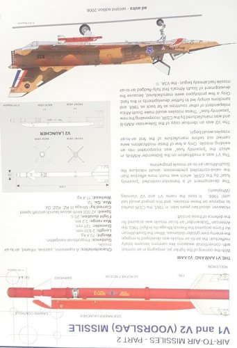

For what it is worth, "Voorslag" means whiplash in Afrikaans.
It is worth noting that the South African AAM development history stretches to a few years earlier than the attached article mentions below (1965)..to the early 1960's in fact, when CSIR work started on an indigineous AAM missile path.
From what I can gather, the indigenously built V2 was "Voorslag", or "Whiplash" in English.
