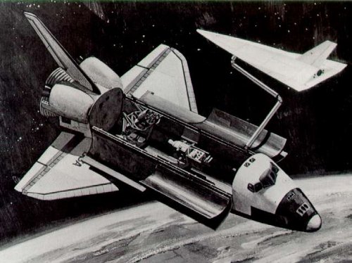

Shuttle-launched MRRV (Maneuvering Re-entry Research Vehicle)
It's the Maneuvering Re-entry Research Vehicle. It was intended to be launched from the Shuttle to explore the hypersonic speed range between NHFRF ("X-24C") and orbital speed. It was to be used in several types of flight patterns, including low angle-of-attack re-entry, high cross-range, etc.
Details in AIAA 1977-1165.

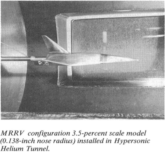

Experimental Investigation of Maneuvering Reentry Research Vehicle at Mach 6 and 20.3
A maneuvering reentry research vehicle (MRRV) has been proposed by the U. S. Air Force as a test bed for experiments in the hypersonic flight regime. The MRRV was conceived as a vehicle that flies in the hypersonic regime along trajectories that the Space Shuttle cannot fly because of aerodynamic and heating limitations. The MRRV would serve as a convenient means of testing thermal protection systems, structural concepts, guidance and control systems, and other future technologies, as well as alternative flight paths for advanced reentry spacecraft.
As part of the study of the MRRV, force and moment tests were conducted on a 3.5-percent scale model of the vehicle in the 20-Inch Mach 6 Tunnel and the Hypersonic Helium Tunnel. The tests were conducted at a nominal Mach number of 6 and Reynolds number of 3.6 x 10^6 per foot for an angle-of-attack range from -4° to 20° and a nominal Mach number of 20.3 and Reynolds number of 6.8 x 10^6 per foot for an angle-of-attack range from 0° to 25°. Lateral-directional data were obtained at sideslip angles of 0° to -4°.
The investigation determined rudder effectiveness, sideslip derivatives, and the effects of body flap and elevon deflection on pitch, as well as the effects of elevon deflections on roll. In addition, two noses of 42 different radii (0.138 and 0.302 in.) were tested to determine bluntness effects.
The baseline vehicle (0. 138-in. nose radius) has longitudinal and lateral-directional stability at angles of attack from 12° (maximum lift-to-drag ratio) to 25°. The blunt-nose vehicle (0.302-in. nose radius) has longitudinal and lateral stability at angles of attack from 15° (maximum lift-to-drag ratio) to 25° and directional stability for angles of attack greater than 15°.​
(Gregory J. Brauckmann, 2483)

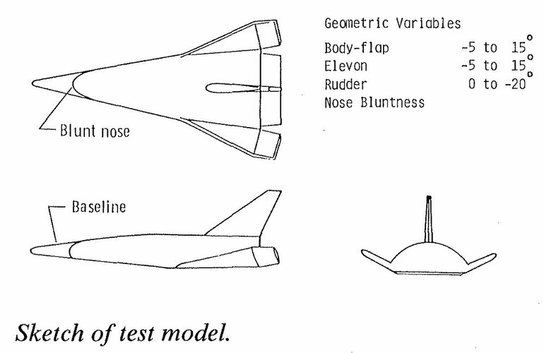

..and in 1985:
Experimental Investigation of Maneuvering Reentry Research Vehicle at Subsonic Mach Numbers
As part of the development of the MRRV, force and moment tests were conducted on a 3.5-percent scale model of the vehicle in the Langley Diffuser Flow Apparatus, which is part of the 8-ft TPT complex. The tests were conducted at nominal Mach numbers of 0.4, 0.6, 0.8, and 0.9 in air for an angle-of-attack range from _2° to 15°. Lateral-directional data were obtained at sideslip angles of 0° and -3.3°.
The test schedule included investigations of the effects of body flap, elevon, and speed brake deflection on pitch, as well as the effects of elevon deflections on roll, rudder effectiveness, and sideslip derivatives. In addition, three noses of different radii were tested to determine bluntness effects. Preliminary analysis of the data showed that although the basic configuration is longitudinally unstable, trim points
exist for several combinations of control surface deflections for the range of Mach numbers tested.​
