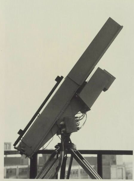

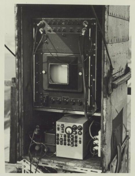

Orange Tartan was a research programme looking at Automatic Astro Navigation in daylight. Problem was to detect a star against daylight sky. Two approaches: a chopping system (as per-IR homing) and a frame-scanning (TV camera) system.
