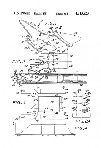

Weird - Northrop's 1985 'Pre-combustion integrated Ram airbreathing laser'

"The present invention provides a Ram airbreathing laser adapted to use with an aircraft which operates primarily in the Mach 3 to Mach 6 regime. Valves, or gates, are provided in the propulsive flow path and the auxiliary flow path for laser in a manner such that the air entering the aircraft..."

interesting, an air breathing chemical laser?
I've seen several AIAA papers with respect to this from the late 80's, iirc. There are also concepts to incorporate such in a scramjet and then use the laser power for ignition/flameholding. The key issue I see is having a uniform enough flowfield in the gas used for the laser cavity to have sufficient beam quality/power extraction. Typically one strives for density fluctuations (del rho/rho) on the order of 10^-3 or smaller. For a typical scramjet flowfield non-uniformities are many orders of magnitude greater than this.
