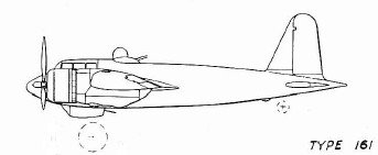

Side view from Bristol Aircraft Since 1910.

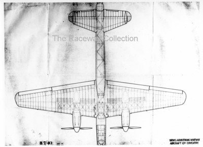

Hi Jerry:
I'll have to look for the AW 48 design, as there are still a number of additional AW dwgs images in the Ashworth files.
But I DID find this chopped off print image of the AW B7/40. I'll have to check the negative boxes. I know there is a negative for this dwg, and it may be full-size and uncropped for a better image.
*Note the two smaller outer vertical fins & rudders, as opposed to one larger, central dorsal fins & rudders.
As you mentioned, above, there is a similarity to the B.1/39 (that I have posted on its Own thread)

The outline drawing of the Type 161 may be solving a bit of a mystery for me. It seems to have been the first design with the Bristol B.14 nose turret, this was a four gun pack that was to have been remote controlled but when eventually installed on the Buckingham prototype there was just the fixed forward firing 4 brownings. One source states that this pack was to have been remotely controlled by the bomb-aimer in the bath-tub whilst another says the pilot was to control it. Neither proposition seems especially practical- the pilot was meant to be flying the plane and the bomb-aimer also had to operate the twin brownings in the rear of his bath-tub. However, I wonder whether confusion comes because in the Type 161/162 the bath-tub is located at the front of the fuselage under the nose where it may have allowed the bomb-aimer a reasonable forward view thus allowing him to operate B.14 whereas on the Buckingham the bath-tub has been moved aft of the bomb-bay which leaves on the pilot with any sort of forward view. Either way the installation seems completely impractical. On the mockup of the Type 161/162 that is visible in the foreground of the famous Type 158 mockup picture I can find no trace of the bath-tub though there is what appears to be a sliding canopy for the pilot and there appears to be no access from the crew cabin into the extreme nose suggesting it was never intended to be used by the bomb-aimer as was done in the Blenheim and Beaufort.
