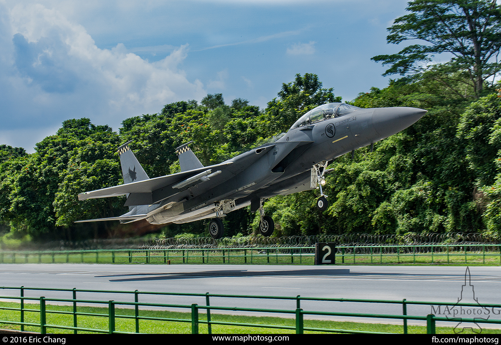

There are more than one military air bases and more than one civilian airports ..... besides the Singaporeans do demonstrate taking off and landing on its highway every few years ..... Check out Ex Torrent .....
I'll take your word for it. A quick google map look made it looks like it was only two locations; I've only spent 36 hours there myself.

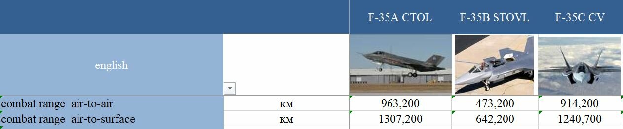

Range is similar. C has more fuel but more drag. Shorter takeoffs and landings would be the only advantage, at the expense of acceleration.
So there is very little in the difference between the A and C models range wise, I am surprised at the extra drag but I suppose that is the consequence of the extra enginering required to handle the stress of carrier take off's and landings.
More drag but also more lift due to larger wing area. It balances out in the end.
Drag come from bigger control surfaces. There is also extra weight from the reinforced structure, even more than the lift fan from what I recall.

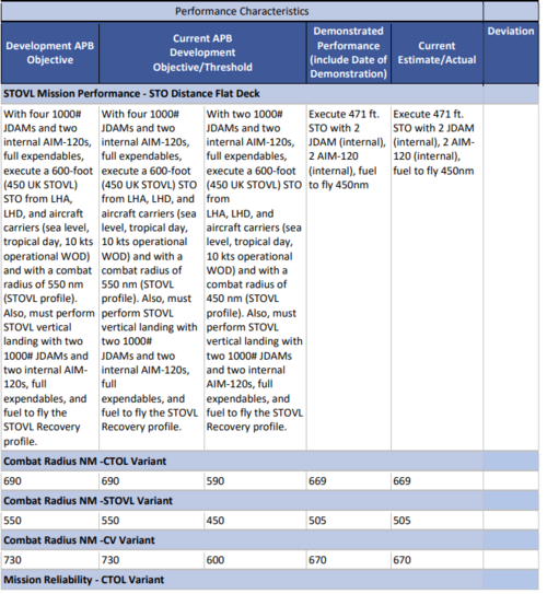

The range is not similar. The C has a substantially higher range than the A when flying the same profile. It can fly at higher altitudes and lower speeds thanks to its big wing. The published range figures are for the C flying a carrier profile and the A flying a land based profile, hence why they are similar.
I’ll take your word for it; I am just using published figures.
Your link is not available to me
It is a .mil link, that's probably why. Here is the relevant screenshot. As I said, the C's profile involves loitering for the carrier landing pattern which takes up some range. I will also make note of the comments by several F-35 pilots, most notably Billie Flynn on the Afternburn Podcast, that " the A was really meant to have the C's wings". This indicates that there is a tangible range benefit to the C's wings that outweigh extra drag and weight.
