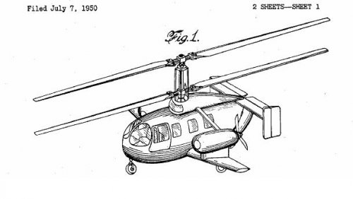

hesham said:
That is the only thing remained to us,the patents;
here is a Design for Gyrodyne,and may be it was GCA.12.
http://www.google.com/patents?id=oYNwAAAAEBAJ&printsec=drawing&zoom=4#v=onepage&q&f=true
And from Aviation Week
index.php

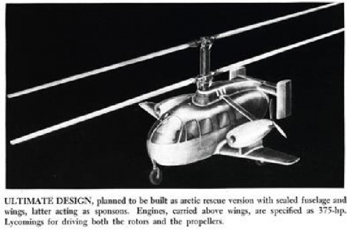

To the best of my knowledge, this was the GCA-7 Helidyne.
The GCA-12 was an HR Class Interim Assault helicopter proposal for U. S. Marine Corps. This doesn't look much like an assault type.
Agree with Stargazer.
That’s with all probality the GCA-7 Helidyne (arctic rescue version with wings), already shown in the thread about the XHP competition (https://www.secretprojects.co.uk/th...erimental-helicopter-patrol-competition.9868/)
