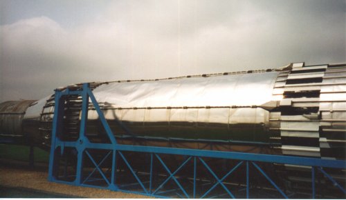

The B S was build like ICBM Atlas
Tanks made out 0,48 mm tick metal Sheets.
you have to keep The empty tank under Helium pressure or the tank collapse.
the B S in Deutsches Museum - Flugwerft Schleißheim at Munich (this not Deutsches Museum in Center Munich) model in best form
the attache Picture shows a Blue Streak at Redo, in Belgium.
Tanks without pressure and bump.

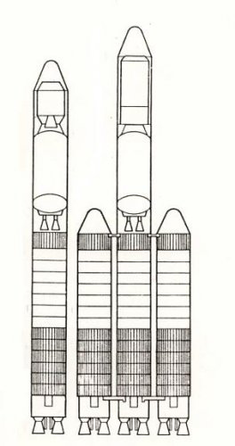

Actually the Europa IV proposal envisaged two Blue Streak strap-ons to be added to the basic launch vehicle.
This picture appeared in a Flight magazine a long, long time ago.

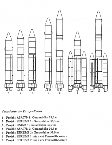

i found picture of French ELDO B proposal
note that SEREB B got 2 Solid Booster like Titan IIIC
of course the centerstage Blue Streak need to reforced.
the the Europa IV proposal
ist that Centaur opperstange or Europe build H/O Stage ?
