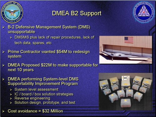

http://smaplab.ri.uah.edu/smap-center/conferences/dmsms02/presentations/smith.pdf

http://www.dtic.mil/cgi-bin/GetTRDoc?AD=ADA397957
"2.5.3.7 The AN/APR-50 Electronic Warfare System
The AN/APR-50 electronic warfare system is currently used on the B-2 Spirit. The system is capable of covering the lower frequencies and up to Band 4 from 500 MHz to 1 GHz. Very little information is available on this highly classified system. ("ADF Employment of the Global Hawk Uninhabited Aerial Vehicle.")"

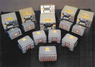

The B-2 DMS (Defensive Management System) includes 3 processors (DMP-1 (ZSR 61), DMP-2 (ZSR 61), ZSR 63). DMP-2 can act as backup to DMP-1 or ZSR-63 processor. DMS includes the TELS (Threat Emitter Locator System), to detect, locate and identify radar transmitters, and PAS (Pilot Alert System), a light detection and ranging (lidar) system designed for detection of contrail formations behind the B-2 Stealth Bomber. It also includes detailed threat location Electronic Order of Battle (EOB) files, Electronic IDentification (EID) libraries and threat detection range display and signature management capabilities. Early Warning radars for example have lines showing detection ranges for "spike" (4 main directional lobes, dotted lines) and "fuzzball" (general return from other angles, solid lines) for each emitter from the 'known emitters" in the EOB file (white) or discovered unexpected emitters (yellow). Flight planning avoids getting to 'fuzzball' ranges, and not straying inside "spike" ranges as much as possible.
The TELS includes a ZSR-63 processor (mentioned above) and a pre-processor. The pre-processor identifies beam report messages from RPs and matches them to known EID (electronic ID) numbers within the EID library file. The processor establishes emitter initial position and attempts to correlate to known emitters in the EOB files or leave as 'pop up' , and sends to DMP for display. The pre-processor has no backup in case of failure, but the processor functions can be run by DMP-2 if the ZSR-63 fails.
The EID Library (One per EID Region) may have up to 200 emitter entries. It can be edited by crew but "nobody touches EID due to its complexity".
TELS has 25 antennas. Spatial and frequency coverage is provided by 17 antennas covering Bands 1-4.
The DMS uses EOB files containing threat emitter locations. 5 EOB sector files are active at one time - 2 behind, 2 in front and current segment. Each segment is 160 NM x 800 NM meaning the total displayed coverage is 800NM x 800NM.
Each EOB sector Core memory stores up to 750 plotted individual emitters in the five EOB segments.
PALS (Ophir Systems) is a LIDAR based contrail detection system. It activates at a certain barometric altitude and warns the crew when a contrail is formed.
