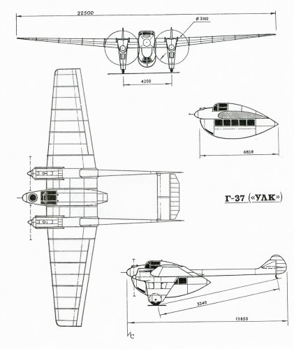

Universal detachable cockpit G-37, in an emergency or on special assignment was supposed to drop by parachute diameter of 40 m. The designation of the parachute G-№? I do not know (( In any case, it is not G-40.
Plans aircraft G-37 - by Ivnamin Sultanov. magazine "Wings of Motherland"

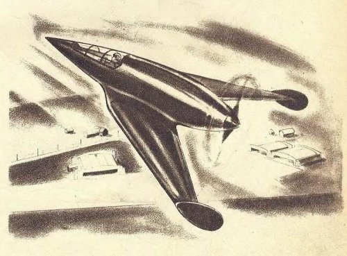

Nevertheless, despite the failure of "Cucaracha", Grokhovsky not abandon hope of implementing the ideas of ram - fighter. Figure plane in the view of the artist A.Preobrajensky of P. Grokhovsky article - "Aircraft of the Future" magazine "TM" № 8-9/1938.

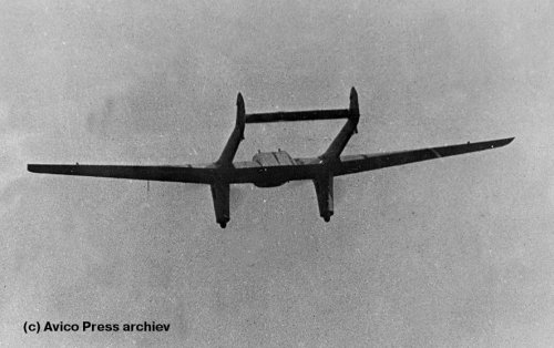

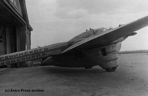

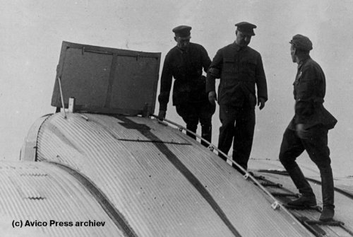

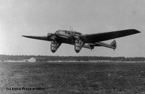

Some pix for dear Hesham
