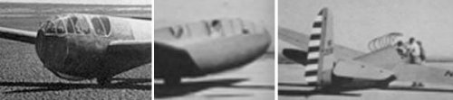

TG-4 - Laister-Kauffmann, LK-10 Yankee Doodle 2, 2-seat training glider
- XTG-4-LK: prototypes for AAF (LK-10A model), 3 built
- TG-4A-LK: prod. model, 150-154-or-156 built [see Shrike's comment, Reply #14]
- TG-4B: impressed Laister-designed LIT 3 Blue Bird* single-seat glider**
-- * built at Lawrence Institute of Technology, owned by an LK employee
-- ** Baugher says single-seat LK10 Yankee Doodle impressed as 42-57191
---- (this may be confusing LIT 3 with the LIT 4, the basis for the LK-10)

Apophenia, you rock! Incidentally, I very recently started to sort out all my Laister-Kauffmann and Schweizer gliders, and the TG-series was on my to-do list... You did a MUCH better job than I possibly could have come up with, for which I'm grateful!

The designation may have been used for the Bowlus XBM-5, a two seat glider (shown in the picture) that was registered NX28386 and which flew in 1942.

.... and specifically the TG-12.
In my records I mention the XBM-5 NX28386 as a possible XTG-12A mainly as the photo shows typical USAAF markings on the tail, next to the civilian registration. My mention is really to prevent somebody from claiming that it is XTG-12A without contemporary proof (trying to avoid the 'inventions').
Hope this makes my statement clearer.
