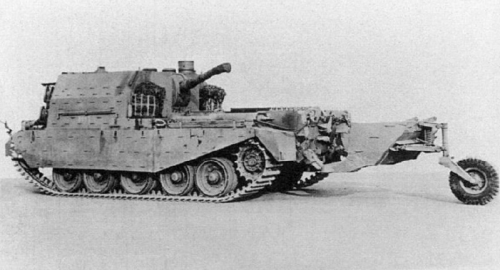

The similar looking FV3802 was in fact quite different. It retained the original Centurion tank's driver position and transmission arrangement and had the QF 25 Pounder gun-howitzer point to the rear like in the Archer self propelled anti tank gun. The hull was cut in length and only two full twin wheel boogies per side with an additional single wheel arrangement. These guns were discontinued with NATO standardization on 105mm and 155mm calibers and the development of the Abbott gun. The FV3809 SP 155mm anti tank would have been a sight to behold…
Is that 'wheelbarrow' arrangement the limber ??
Its not a wheelbarrow its a trailer the vehicle travels with the gun pointing towards the rear. This trailer was the highly unpopular 'monowheel' fuel trailer issued to early mark Centurion tanks to make up for their short range.
Didn't some flamethrower conversions also use that arrangement, or am I wrong?
Nope the Centurion Crocodile would have had the same trailer as used by the Churchills. The monotrailer was just a fuel tank to extend range, they eventually added the extra fuel tank onto the rear of the tank before later marks had the rear end redesigned to incorporate the fuel tank within the rear of the hull.
