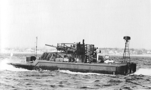

Most of the initial generation of the US Navy’s brown water force for VietNam were based on modified LCM6 craft. The second generation was to include purpose designed ships and capabilities improvements. The primary criticisms of the LCM6 based craft was high draft (>4 feet), low speed (<8 knots), vulnerability to mines and >12.7mm rounds and low manoeuvrability and seakeeping.

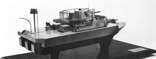

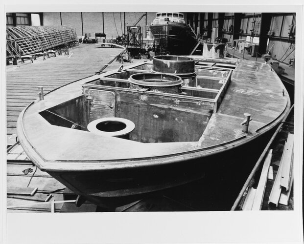

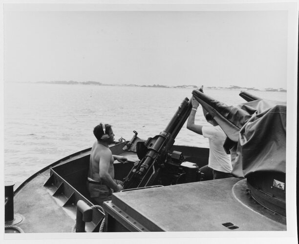

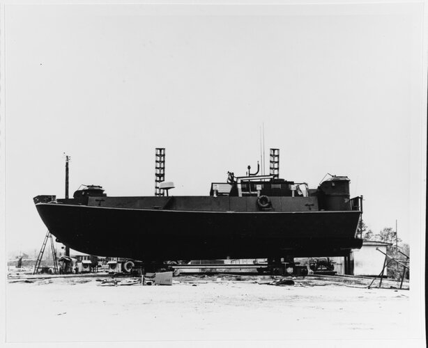

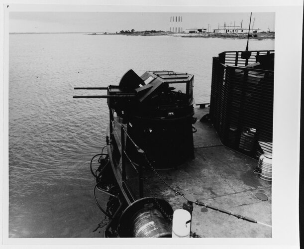

The late 1966 requirement for the ASPB Mk 2 [Assault Support Patrol Boat] was a max speed of 25 knots, range of 250 NM (while cruising 15-20 knots) and the same dimensions as the ASPB Mk 1. The additional speed was so it could tow a chain sweep in fast flowing rivers and tides. Proposals were received by the end of June 67 and orders for prototypes awarded to Sikorsky June 12, 68 and Sewart (Teledyne) June 28, 1968. Both vessels passed their operational evaluations and were declared surplus in 1980. The Sikorsky boat was appreciated for the firepower of the 105mm howitzer but had serious mechanical problems. The Sewart boat had a Navy 81mm mortar in a well right at the bow for bunker busting. It had three Mk 48 turrets each with a 40mm Bofors gun from the AC-130 Spectre gunship. The Sikorsky boat only had a single Mk 48 turret in the bow. The production plan for the ASPB Mk 2 was service prototype deliver in 12/68 with approval by 4/69. Contract signing in 7/69 for first deliveries in 3/70 and continuing at a rate of four per month for two years. Cost was estimated at $800,000 per unit and it looks like both Sikorsky and Sewart were to receive contracts to meet the demand.

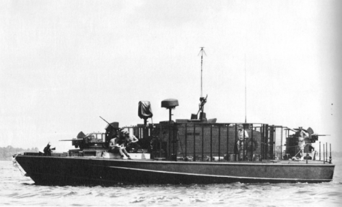

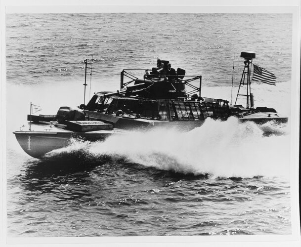

Thanks Abraham. That bottom pic of the Sikorsky ASPB is the best one I've seen as far as determining scale.

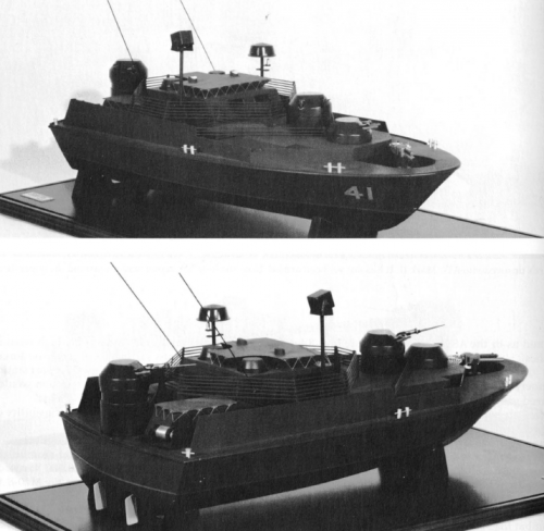

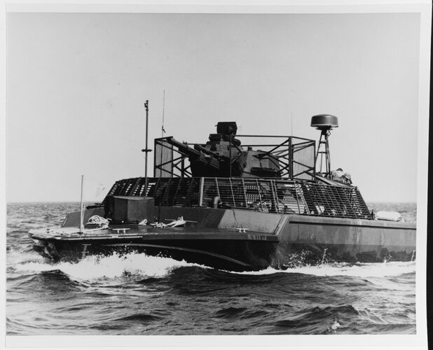

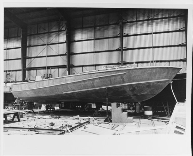

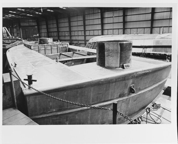

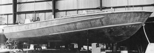

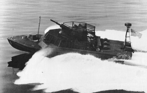

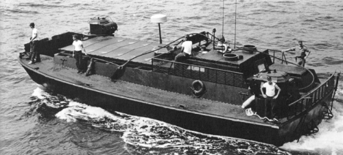

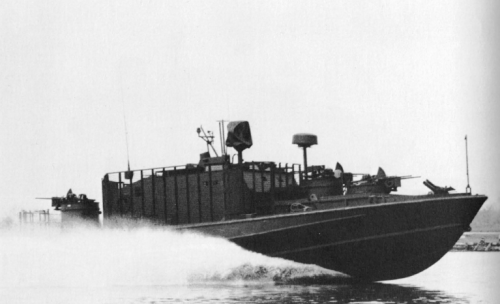

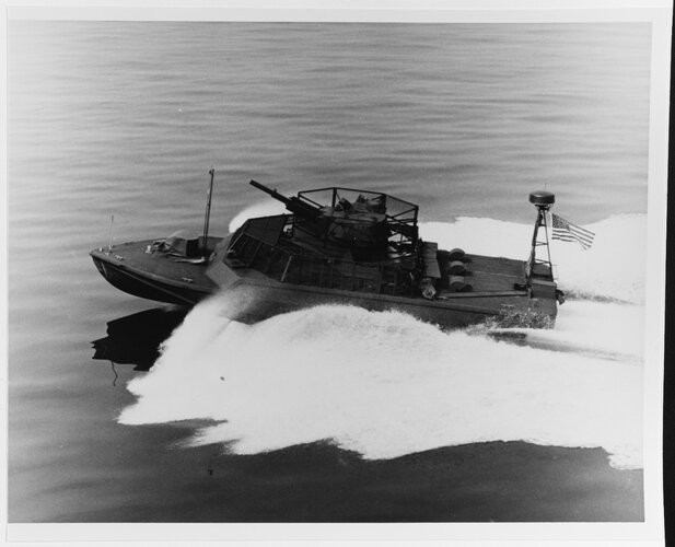

So the first 4 photos are of the model, and of the prototype, of Sewart Seacraft's ASPB entry. Any idea where that prototype ended up?

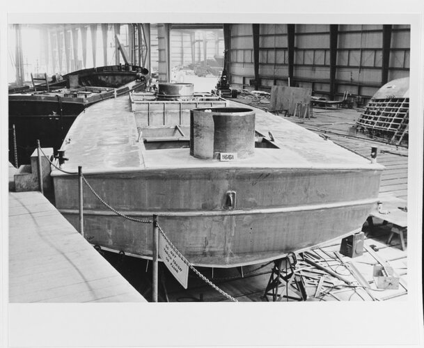

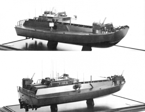

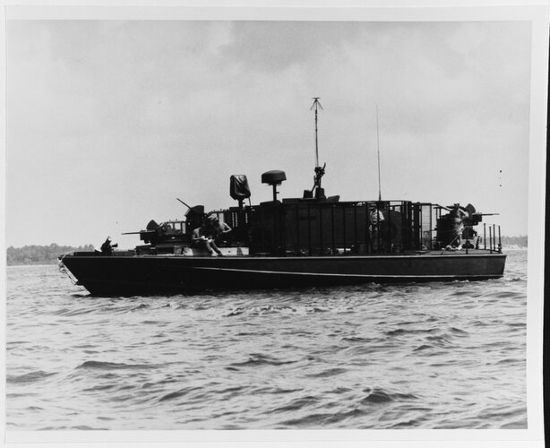

The 2nd generation of RAS craft was also to include a modular ATC (Armoured Troop Carrier).
The initial requirement for the new ATC was to carry 15-30 troops, down from 40 in the LCM(6) based ATC, but with the ability to rapidly disembark via a ramp or over the side. The CCB [Command and Control Boat] version was to carry a staff of five in place of the dismount unit. Speed of 25 knots was preferred but 20 knots was acceptable. Later the troop load was increased to 60 with supplies for two days and speed reduced to 15 knots with 15,000 lbs load or 12 knots at 20,000 lbs. Protection was to defeat RPG-2 and 75mm RCL. The ATC could be converted to a monitor with a variety of modules to be developed by Naval Ordnance Laboratory. The main monitor module was armed with the 152mm gun launcher turret of the Sheridan tank. Lighter modules carried either flamethrowers or the 106mm recoilless gun backed by MGs.
The Sewart ATC/CCB failed its operational evaluation in January 1969. It made a top speed of 26.2 knots but failed to meet the minimum sustained speed of 16 knots (only making 13.2 knots). Endurance was 170 NM instead of 250 NM and turning circle 75’ rather than 50’. It was also noisy, the coxswain had limited visibility, propulsion vulnerable to debris and no covered access to the gun turrets. It could carry 44 troops or a M113 APC.

Thanks for these Abraham: These are of particular interest given the current focus on litorral matters by the US and other navies.
Just a point of order. Except for the last photo of the ASPB, the source seems to be Norman Friedman's US Small Combatants an Illustrated Design History
