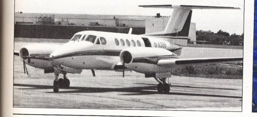

One of Beechcraft's lesser known efforts has got to be the single King Air 400 (Model PD-290), a 1975 experimental turbojet conversion of a King Air 200.
Quote
When Cessna unveiled its Citation in 1972, it was evident that at least some of Beech's future markets would have to be in jets, so in 1975, Beech built a testbed for jet aerodynamics and systems. Using the first King Air 200 prototype, engineers replaced the two turboprops in the wing nacelles with two Pratt & Whitney JT-15D-4 turbojets. The rather striking PD (Preliminary Design) 290 accumulated 93 hours on 103 flights between March 1975 and September 1977, apparently gathering enough information to convince the company to resume the search for a ready-built design. In late 1985, Beech announced it had purchased the design, tooling and rights to manufacture and market the Mitsubishi 300 jet.
Source
The prototype was modified from the very first King Air 200 (c/n BB-1), which had been registered on Oct 27, 1972 as N38B. Its later disposition is not known very precisely, but presumably it was reverted to King Air 200 configuration with PT6A engines, and was written off in March 1980.
Any other pics or info would be much welcome!!

Hi Stéphane,
this is the only other picture I know of.

It's hard to imagine what they hoped to learn from a mash-up like this in 1975.  This is the sort of thing produced in the late 40's to gain experience with jet design and operations.  By 1975, that experience was widely available even if Beech didn't have it in-house.  To justify the expense of kluging this together, the lessons to be learned must have been tied to the King Air configuration or specific systems.

They probably learned that it was a really dumb way to build a jet.
