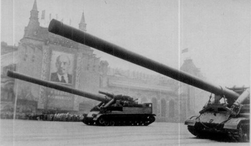

In InterAvia 2/1959 I found this photo of two sowjet self-propelled guns. The caption says,
they for long-range ramjet powered rounds. The same type I found on http://forum.panzer-archiv.de/viewtopic.php?t=7492,
here described either as recoilless guns or mortars, capable of firing nuclear rounds.
It seems, that only those two examples were built. Any additional information ?

It's 406-mm SPG 2А3 "Конденсатор" (Объект 271), nuclear gun. Was released only four vehicle, but were replaced by missile systems. Do not be mistaken with 2Б1 "Ока", 420-mm nuclear mortar.
More precise: on the photo in the far distance - "Конденсатор". Near distance - "Ока". Differ cylinder recoil mechanism on the barrel "Конденсатор". "Ока" don't have it, because the mortar with a fixed barrel.

Many thanks ! Honestly I didn't realise, that the vehicle in the foreground
is a different one. Mobility seems to have been better, than that of the
US M 65 "Atomic Annie".

Pay attention to external shocks absorbers оf this 420-mm mortar
In addition: here's an image 406-mm cannon. No shock absorbers, but there recoil mechanism on the barrel.
