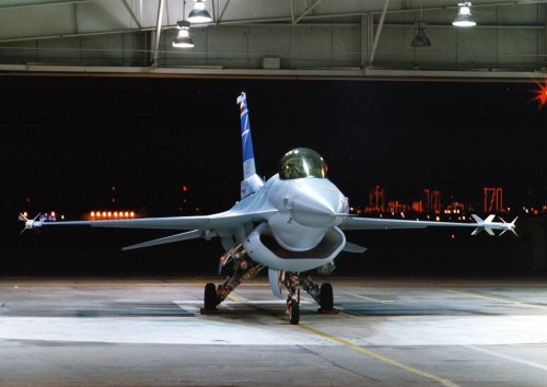

F-16 DSI inlet testbed

Imagine this intake combined with the cranked delta wing of the F-16XL, with the avionics/engines of the latest Block 60 UAE Viper!
http://www.dfrc.nasa.gov/gallery/photo/F-16XL1/Small/EC97-44354-3.jpg
Would be nice to see a production F-16 with that inlet. Supposedly it performed better than the standard inlet.

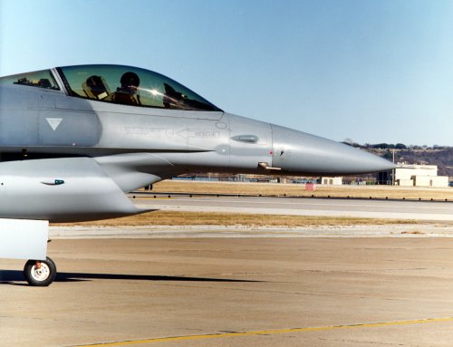

another present from Lockheed's CodeOne Magazine staff
Sideview of an F-16 modified with diverterless supersonic inlet, or DSI, developed for the Joint Strike Fighter -- now the F-35 Lightning II -- program. At high aircraft speeds through supersonic, the bump in the inlet works with the forward-swept inlet cowl to redirect unwanted boundary layer airflow away from the inlet, essentially doing the job of heavier, more complex, and more costly diverters used by current fighters. The flight test program consisted of twelve flights flown in nine days in December 1996.

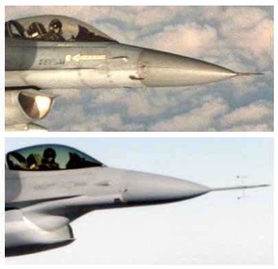

More pics:

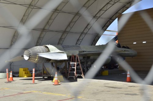

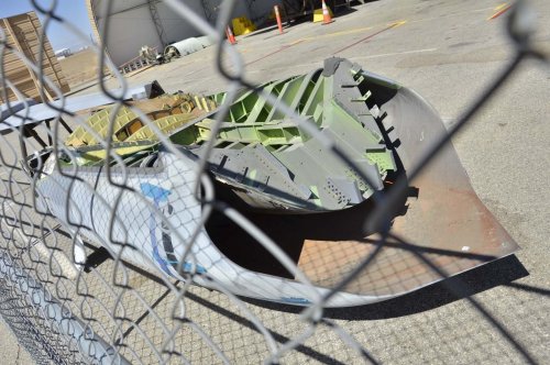

There is too much detail for that to be the RCS "model". I believe that is the actual airframe.
Adam
quellish said:
mr_london_247 said:
It's previous location was at:
32.786889°
-97.447521°
Not sure how it got to Palmdale. It does appear that is the actual aircraft.
I suspect that it flew there when we finished testing it. I do believe that is a Lockheed owned F-16, not a US Gov't owned one.
