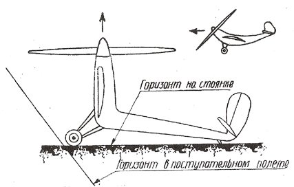

I don't know that designer and this project was from 1944 as
VTOL fighter.

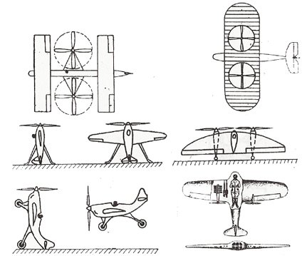

Anther projects from 1921 to 1939.

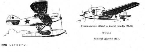

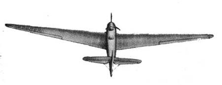

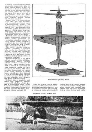

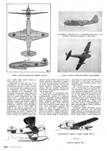

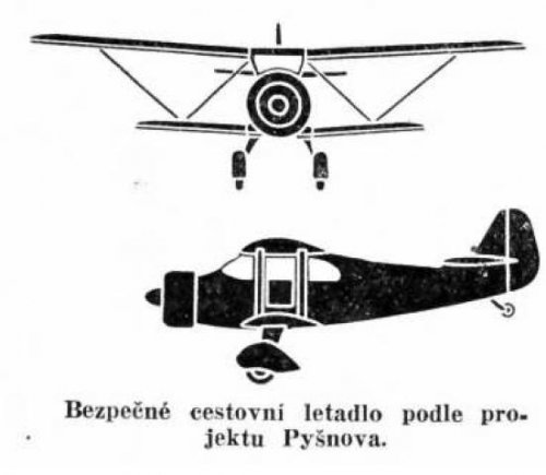

I can't ID those two aircraft well,the first called MI-4,and the second called or designed
by Pysnova,can anybody help ?.
Name for the second image is Pishnov.
As for MI-4 and MI-13 in the first picture, we'd need to see the page to determine the name of the designer.
Hi Stargazer,
here is the a part,about three pages from the article,may be it can help.
This is too small I'm afraid. However, the paragraph that mentions "MI-4" and "MI-13" doesn't seem to indicate a designer. Previous paragraph was about Polikarpov R-Z and I-17, next one is about Tupolev's ANT-40.
The "MI-13" is described as heavy fighter / attack version of the SB (ANT-40), armed with one 25-mm (?? - Such a caliber never existed in the Soviet Union...) nose cannon and two movable machine guns. I think they meant the DI-8 (ANT-46), but described it under the wrong name and placed not very correct picture of it. Once I described the actual DI-8 here: http://www.secretprojects.co.uk/forum/index.php/topic,7951.msg70342.html#msg70342.
The "MI-4"... a beautiful aircraft, but seems to be pure fiction :( . According the article it was not even a project, but a real prototype flown in 1932 - the naval fighter with M-17 engine and interchangeable landing gear (wheels or floats). But I don't know any real Soviet fighter with similar appearance ??? .
It seems that the Czech author thought that "MI" index means Morskoi Istrebitel (maritime fighter) - the "MI-13" is also described as naval aircraft. But in reality, "MI" stood for Mnogomestnyi Istrebitel (multiplace fighter}; so the aircraft like this "MI-4", if it would exist, could not carry such a name. There was actually a specification for an aircraft named MI-4: it was issued for TsAGI (i.e. Tupolev) as a replacement for their unsuccessful MI-3 (ANT-21). It was scheduled into the prototype aircraft construction plan for the years 1934/35, together with its bomber version called BB (Blizhniy Bombardirovschik - Short range bomber). The real MI-4 would be a twin-engine monoplane with two Wright Cyclone or Hispano-Suiza 12Y engines. The bomber version of it turned at least into the SB (ANT-40), while MI-4 itself was cancelled (or we can say it incarnated into the DI-8?)
Great post as always, redstar72! Thanks a lot for providing such detailed and factual explanation and debunking the myths...
The most funny thing is that if MI-4 (the real one) would be built, it could look much like "MI-13" from this article... ;)

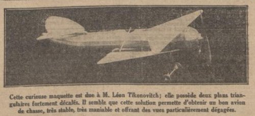

in Les Ailes journal,a strange Model to unknown fighter,may be just a suggesting
aircraft,for the designer Leon Tikonovitch,but I think the right spelling is Leonid
Tikhonovich,with a triangular two wings,set inverted to each other,did anyone
hear about it before ?;
http://gallica.bnf.fr/ark:/12148/bpt6k65557564/f15.image

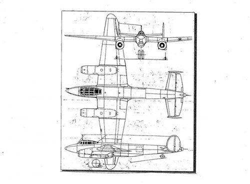

From the Member McGreig,

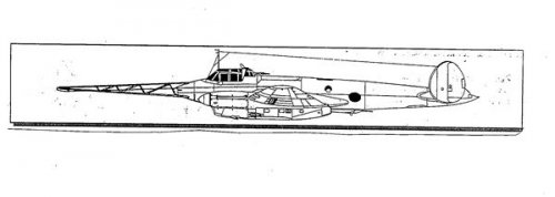

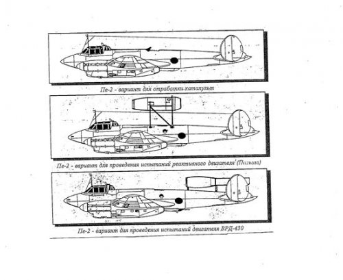

and from the whatifmodelers site,I want to ask,are all of those Petlyakov Pe.2 a real projects ?.
http://www.whatifmodelers.com/index.php?topic=33705.0
Yes, real.
1) Pe-2 I-RD http://www.secretprojects.co.uk/forum/index.php/topic,3019.msg24293.html#msg24293
2) "Paravan" balloon cable cutter, with an open structure of the beam front nose support cable cutting (this prototype was actually built)
3) Various testbeds
4) DIS-2 (VK-107) http://www.secretprojects.co.uk/forum/index.php/topic,1975.msg17122.

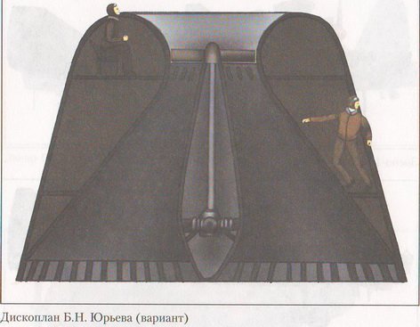

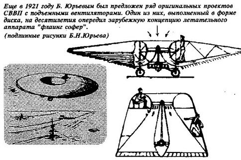

a strange flying disc or disc helicopter,as they called it,who heard about it before ?.
http://artofwar.ru/i/iwan_d/text_0750.shtml
From early post.

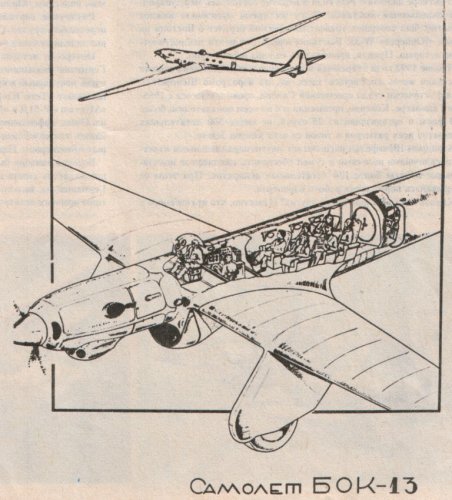

here is the BOK-11 and BOK-13,the BOK-11 was high altitude experimental recce aircraft,and
the BOK-13 was a transport aircraft project.
http://young.rzd.ru/blog/public/ru?STRUCTURE_ID=704&layer_id=3833&id=94793&page3833_3489=2

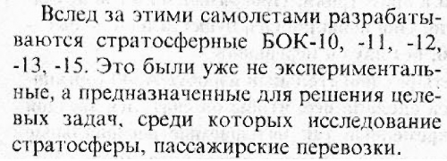

a small info about BOK-10,11,12,13 & 15.
That BOK-13 is quite impressive, but I don't buy the transport designation. Were that massive engine, long wings and clearly pressurized cockpit and cabin all for carrying six passengers? Seems ludicrous for a transport, but as a long range, high altitutude reconnaissance aircraft project disguised as a transport, it makes a lot of sense.
My dear Cluttonfred,
frankly,I don't know,may a Russian members can ID it well.
Indeed. Has a Heinkel He 119 feel to it.
Slight possibility that the idea was to get extreme range from high-altitude flight?

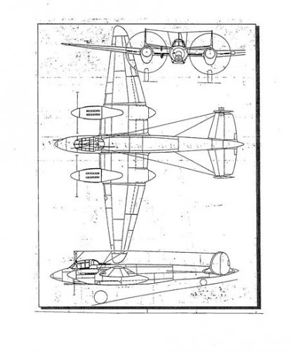

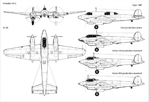

from the book; Soviet Combat Aircraft of the World War Vol.2,here is a drawings
to a strange Petlyakov designation "Pe.33",I want to know if it was right designation
or a misprint ?.

First time I saw this designs and the bok-13 is very interesting because it's very advanced: massive engine, long wings and clearly pressurized cockpit and cabin but "fixed undercarriage"? It's a bit strange. Sadly we don't have more drawings.
