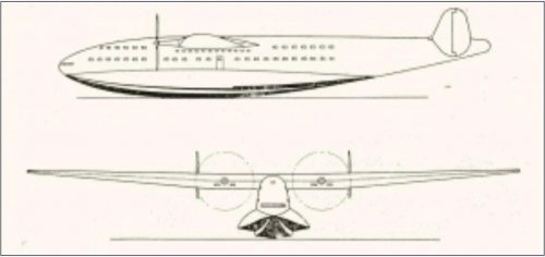

the Koolhoven 100 ton flying boat project.
Would that K 100 tonne be purely napkinwaffe as drawn, or were there available engines to be ganged / contra-propped to haul that Flying Whale ??
Wing looked thick enough for 'engine room & oiler team'...

The 100 ton Koolhoven flying boat was te first proposal
by Fritz Koolhoven for a giant flying boat.This one dated early 1930's
and was of all metalconstruction

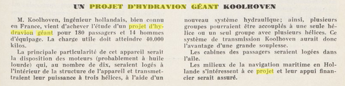

One source - Cockpit: May-June 1973-mentioned the use of 10 engines -raw oil type- coupled to 2 large props.
Payload should be 40 tons. Crew:14.Passengers:180.

1932 giant flying boat Project.
L'Aerophile 1932

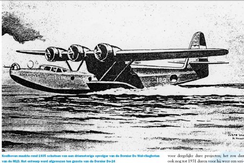

Also in my files,
the Koolhoven designed a recce flying boat monoplane Project of 1930s,powered
by three engines,no more details are known ?.
Very few info is available of this project..
It was high wing 3-engined flying boat proposed
for the Dutch MLD - Marine Luchtvaart Dienst or Air Service.
A drawing of this project was shown to Prince Berhard during his visit
to the Koolhoven works on 19 November 1936.
Exept for an artist impression made by Justus van Hattum
who was at the time 'inhouse' artist with Koolhoven nothing
more is known of this rather impressive flying boat.
