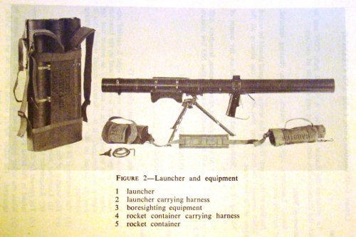

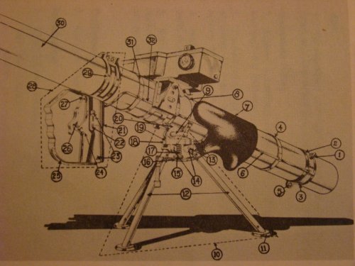

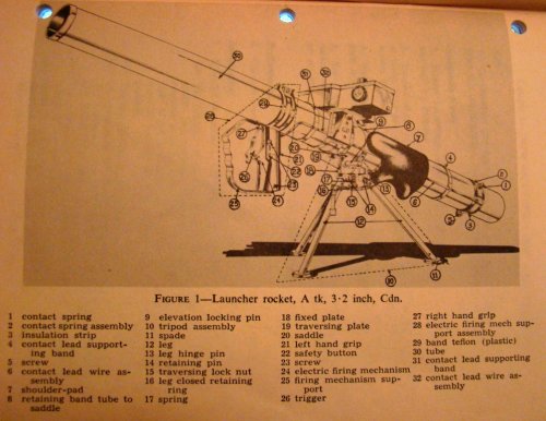

I was doing some research and accidentally came across your post about the Heller. I don't have any actual photos of the weapons system, but I have a manual for it. The quality of the photos might not be too good, my scanner is dead so I had to photograph the pages of the manual. Hope these are of interest to you.
Cheers,

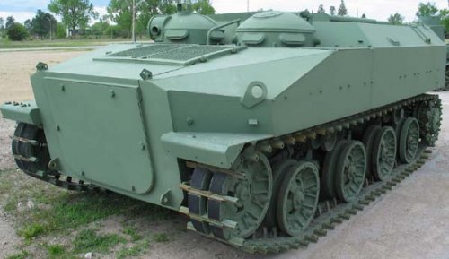

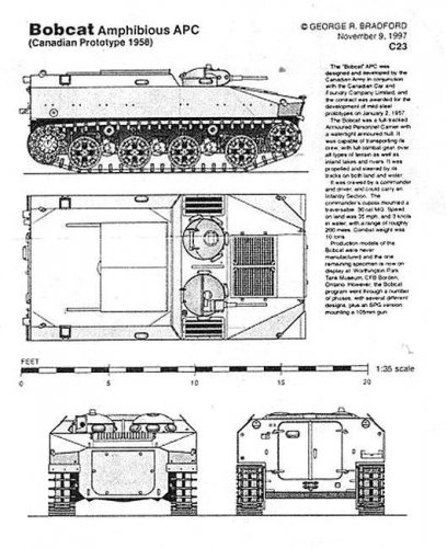

I can assume that these 'tracked vehicles' depicted in the book you've mentioned are of the Bobcat family. Could you please post here (in a new thread rather than this one) some of their pictures as well as other info?
Regards,
Piotr
[Added]
Piotr, Just saw your post on Maple Leaf Up ( http://www.mapleleafup.org/forums/showthread.php?t=2633 ). You already have way more than I do! :-[
A 4-view drawing by George Bradford and the preserved Bobcat at Borden.
See Clive Law's Service Publications for more: http://www.servicepub.com/
Well, the Bobcat is definitively one of my favourite might-have-beens, so for a long time I have been looking for any info on that. And from time to time I share what I know with others. ;-)

Cheers Piotr.
For those who don't check that link...
from the Canadian Army Manual of Training Infantry Platoon Weapons Launcher Rocket A Tk 3.2inch CDN. 1956
Launcher - 54 inches long (137.2cm)
Launcher with tripod - 28.5lbs (12.9kg)
Rangefinder Sight - 5lbs (2.3kg)
HE A tk rocket - penetrate 11 inches of homogeneous armour at 90 degrees and approximately 5 inches at 64 degrees
Maximum Range - 2860 yards (2615m)
Operating Range - 300 yards (274m)
Maximum Effective Range - 450 yards (411m)
Maximum Rate of Fire - 5 rounds/minute
