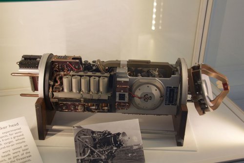

Can't really tell exactly what this is from the info board in the photo - seems to be a semi-active radar seeker?

A very interesting find.
Yellow Feather was a CW seeker research project.

Indeed, very interesting.
That might be the Badger X-band seeker that was used in the Caravan programme to develop a SAM seeker. I believe Yellow Feather covered IR and radar seekers for SAMS and AAMs.

Yeah it would be nice to read the info fully, it mentions Firestreak.

The TRE/RRE carried out a semi-active CW homing head research programme during the 1950s involving carry trials by Meteor, and firing trials using a CTV4 test vehicle. The Yellow Feather designation seems to have been applied to the latter circa 52-55.
