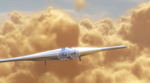

Here is an artist impression of the plane.
There have been a number of planetary plane ideas over the years. There was one for a Mars flyer about a decade ago. A few years ago there was one for a Titan airplane. I think that the Mars flyer got more work done on it than the others. The problem was that it was being proposed for a program that did not allow high technical or programmatic risk, so it was not going to win. For NASA competed programs like Discovery and New Frontiers they do not allow new tech development--you have to be ready to go with your design if they approve you.
The Titan plane was rather cool, but I think it was a very immature proposal.
to be less at the mercy of (unknown yet) winds?
A balloon would be simpler.
Presumably they want control so that they can send it to specific locations to take measurements. But that raises the question of whether doing that is so important that it is worth the cost and risk. If you can collect 80% of the data for half the price of an airplane isn't that a better solution?
Realistically, this aircraft is almost certainly going to be inflated and buoyant to some altitude; I just see this as being an airship / balloon with a more streamline / efficient shape for maneuvering.
