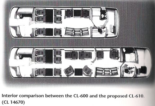

Cabin layout of the abandoned Canadair CL-610 project and CL-600 for comparison.
Ron Pickler & Larry Milberry - "Canadair - The First 50 Years" (Canav) ISBN 0921022077
