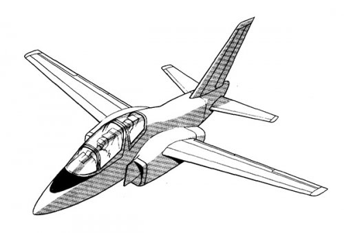

General Dynamics is working on a T-tail design with an all-up weight of 12,000lb, a top speed of Mach 0.85 and a range of more than 1,000 n.m.

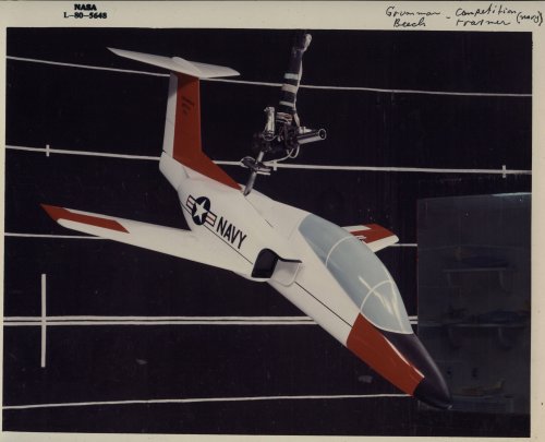

Grumman and Beech have teamed to offer a T-tail, twin-engine design. Of note are the intakes with extended upper lips for high angle-of-attack flight

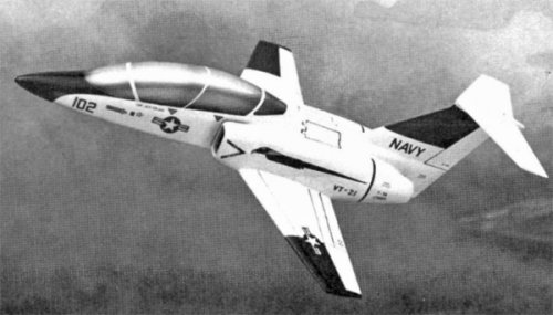

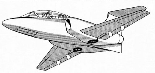

McDonnell Douglas has teamed with British Aerospace to offer the Hawk but is also working on the new design represented here. Engines are mounted in wing-root pods to ease maintenance

General Dynamics' VTX-TS proposal to the US Navy weighs in at less than 12,000lb; has a maximum
speed of Mach 0.85; a carrier approach speed of less than 115kt; and a low-level navigation radius
of more than 450 n.m. GD has teamed with American Airlines and Control Data to offer a training
system capable of producing 600 pilots a year on 300 aircraft

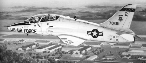

T-45 for the USAF.
Roy Braybrook, Military Training Aircraft of Today (Foulis 1987)

Grumman-Beech-Link System 730
(Grumman G-730)

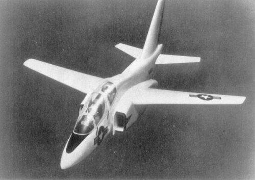

GD/Convair Model 603E
Grumman/Beech Design 730
Northrop Model 351

Here are two other pictures of the McDonnell Douglas VTX proposal that were originally submitted by Jemiba on September 06, 2009 (from FlugRevue 1/1981):

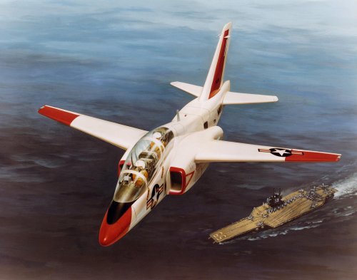

A recent find, color artwork for the McDonnell Douglas VTXTS Submission.
Enjoy the Day! Mark

Mark Nankivil said:
Greetings All -
Enjoy the Day! Mark
That is meant to be the USS Forrestal in the background. Some of the aircraft that are parked on her deck are interesting. Artistic licence / just in a rush to beat a deadline?
By the way, VTXTS was also known as the Undergraduate Jet Flight Training System.

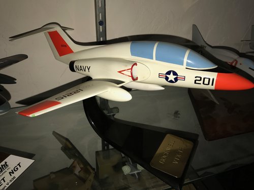

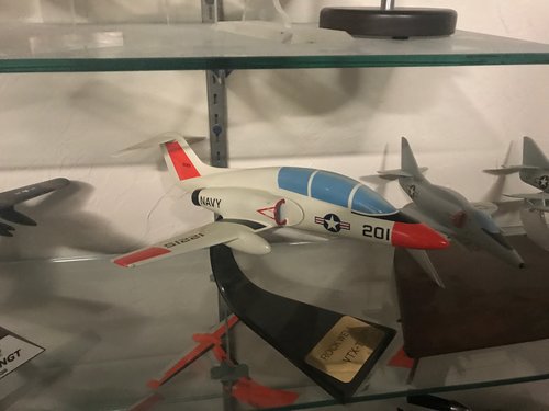

From Rockwell......This was added to my collection several years ago. What is interesting is that this is not a typical resin or fiberglass model, but a rather lightweight hollow-cast construction almost like a formed plex reminiscent of the old light weigh clear canopied NAA models that came from the Floats Company back in the day. BTW We are trying to get a history of these guys so if you have info please share. Model is about 14 inches end to end.

Its definitely Rockwell - aside from Allyson's model which proves it, its basically the same design as the low wing design. It looks like they tried two variations from the T-2 "mid tail" position, a high t-tail and a low tail, and went with the low tail.
Bingo! As Paul notes, you model is a near perfect match to the artwork I posted - thanks!
You truly have an amazing collection!
Enjoy the Day! Mark

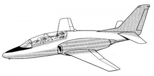

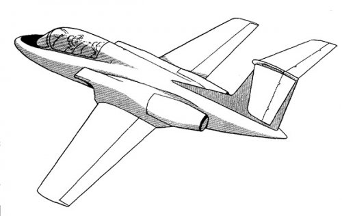

A VTX proposal from Convair, found in the SDASM Archives. Note that it has more than passing resemblance to Cessna's later JPATS proposal:
