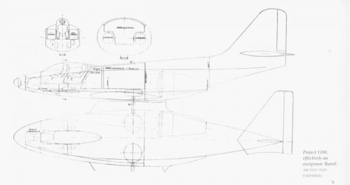

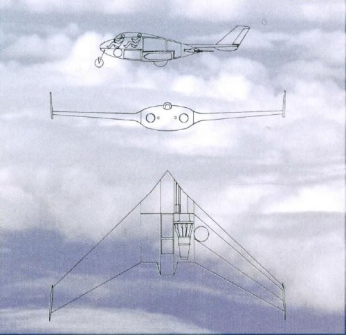

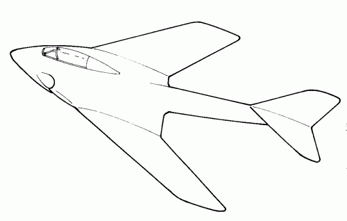

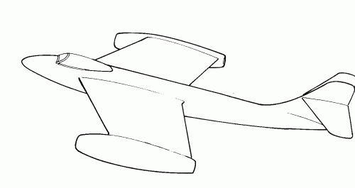

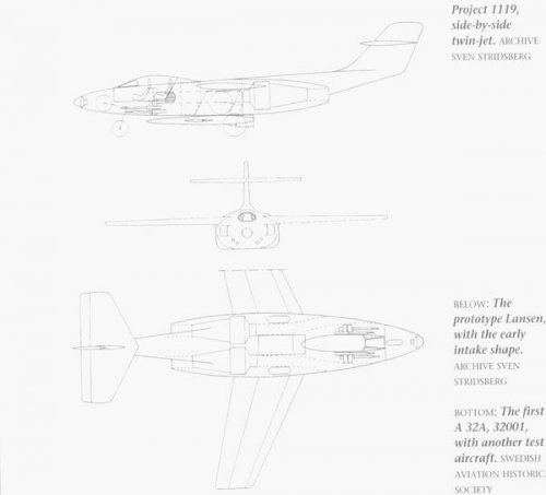

That aircraft passed many developments,in the beginning the company
suggested that project P.1119,it was SAAB-29 in new shape as side-by-
side twin jet aircraft,then moved to Ray,it had a flying wing configuration,
later modified with a slim rear fuselage and T-tail and also twin jet,the
last modified to a tip jet project,the engines was mounted at the end of
wing,a project P.1100 was a twin engined but was not accepted,and
finally the project P.1150 two seat single engined aircraft which was known
as SAAB-32 Lansen.

There was quite a comprehensive article in one of the last
AirEnthusiast issues :
- The "Ray"
- The "Tip Jet"
- Project 1100
- Project 1119
